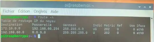

  3. Here is my routing table at boot : enter image description here
I have the feeling the first line in this routing table is bad. When I use this command:
route add default gw 192.168.60.200 eth0
It adds the corresponding line to routing table and internet starts working.

If the routing table is on a fresh flashed unmodified Raspberry Pi OS based on Debian Buster then you do not get a default gateway address from the remote DHCP server. The first line in the routing table is not a problem. It is a valid route to network 172.16.0.0/16 behind gateway 192.168.60.254, so you can connect to devices on this network.
Because Ubuntu and MS Window$ get the default gateway 192.168.60.200 on network 192.186.60.0/24 it may be possible that default dhcpcd on the RasPi has a setting that the DHCP server does not understand. To check this you can try to use another networking system. If you like you can use systemd-networkd for testing. How to do it, look at Use systemd-networkd for general networking and follow section ♦ Create interface file for a wired connection.
