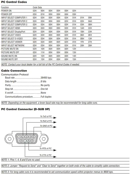

This is the page from the projector manual detailing the control codes
This is the page from the projector manual detailing the control codes. I am only using power on, HDMI, and Power off. I have shorted the RTS and CTS on the converter end.

Shorting CTS / RTS lines is meaningless, you should rather leave them unconnected if you don't use flow control. Note that CTS / RTS signals are available on Pi side (pins 11 and 36, respectively), but they are rarely needed and not enabled by default.
I'd say, you have two ways of debugging:
  1. Get a USB to serial converter (and perhaps connect it to a laptop instead of the Pi) to exclude any hardware problems and debug the projector protocol.
  2. Connect your converter to a computer instead of the projector to exclude the protocol-related issues and debug the hardware by checking raw data being sent/received.
The #2 can be replaced by a loopback test (shorting the TX and RX pins on RS232 side), but bear in mind that the converter is likely to understand its own signals even if the signal amplitude and baudrate are wrong.
