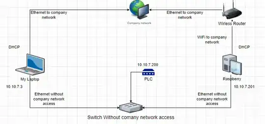

Network description
I need to connect both because:
  • The wifi provide network connectivity for ssh and internet (DHCP)
  • The ethernet connect to the local network and communicate with a PLC (Programmable logic controller) (Static IP: 10.10.7.201)
Network image
Actually my laptop is temporarily connected to both the network because the PLC needs to be programmed, so I have connected all to my laptop.
As asked in the comments:
The Raspberry is connected wireless as client uplink to the internet router. It does not provide an access point. On the ethernet side there is a device wired connected to the Raspberry. The wired subnet is local and has no connection to the internet. I can confirm that.
  1. Are there more devices on the wired subnet using a switch?
    On the switch there are connected:
    • Raspberry as 10.10.7.201
    • PLC as 10.10.7.200
    • MyLaptop as 10.10.7.3
  2. Are there other devices wireless connected to the internet router?
    Yes, there are many devices (It is the company network)
  3. Should wireless connected devices communicate with wired connected devices?
    No, the Raspberry is the only one device that must access the wired connected device (PLC). Essentially I have a Python flask webserver on the raspberry that act as interface between the user that connect to the webpage (using the wirless raspberry IP) and the PLC (That is on the wired connection)

The setup should not be a big problem because there are no routing requirements. The wired subnet is isolated from the wireless subnet. So you can just connect wireless to the internet router with wpa_supplicant as usual. The wired connections should work out of the box when only using static ip addresses and no name resolution. To be more comfortable you can enable a DHCP server on the wired subnet and use dDNS fore name resolution on DNS domain .local. You have only to ensure that the ip subnet on the wired subnet differs from the ip addresses on the wireless subnet.
You can find an example at How to make Raspberry Pi 4 as “WIFI” -> “Ethernet” adaptor but that works as router that we do not need. Just omit the routing and DNS stuff in /etc/systemd/network/04-eth0.network by using this file instead:
rpi ~# cat > /etc/systemd/network/04-eth0.network <<EOF
[Match]
Name=eth0
[Network] Address=192.168.4.1/24 LLMNR=no MulticastDNS=yes DHCPServer=yes EOF
If mDNS (Multicast DNS) is supported by the devices you should be able to address the RasPi from the Laptop with ping raspberrypi.local and the PLC from the RasPi with, e.g. ping plc.local. Be sure that you do not enable routing/ip forwarding on the Laptop and on the RasPi. This may confuse the network with connection loops.
