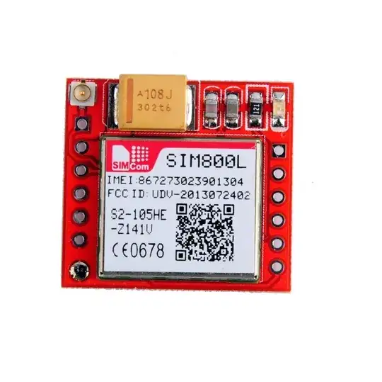

I have a SIM800L module and a keypad module that I want to connect to the raspberry pi 3B+ but then when I had all my modules and stuff I found out that the raspberry pi had only 1 UART (1RX & 1TX) pin I have 2 devices that I want to connect to that...
so my question is: Is it possible to connect SIM800L to another GPIO pins and use them as RX TX? to use serial communication? or is there any other platform like I2C & SPI that I can use with SIM800L?
SIM800L
