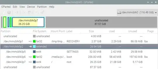

As Seamus pointed out my file-system seems to be read-only. I used apple-pi-baker to flash this drive from a backup. I just don't have physical access to this device since its across the country atm at my university.
/home/pi $ mount -l -t ext4
/dev/mmcblk0p7 on / type ext4 (ro,relatime) [root]
I have added the fs check commands to the bootline which was in a different location than /boot
/home/pi $ sudo ls -lsa /media/pi/boot/cmdline.txt
1 -rw-r--r-- 1 pi pi 179 Dec 31  1979 /media/pi/boot/cmdline.txt
/home/pi $ sudo cat /media/pi/boot/cmdline.txt console=serial0,115200 console=tty1 root=/dev/mmcblk0p7 rootfstype=ext4 elevator=deadline fsck.repair=yes fsck.mode=force rw rootwait quiet splash plymouth.ignore-serial-consoles
I think my raspberry pi is able to boot to desktop due to the rw in my cmdline. B/c without it I get read-only file system errors at boot. But I also this this might be leaving parts of the filesystem to be read-only?
/home/pi $ sudo df -h
Filesystem      Size  Used Avail Use% Mounted on
/dev/root        26G   21G  4.1G  84% /
devtmpfs        3.8G     0  3.8G   0% /dev
tmpfs           3.9G   52M  3.8G   2% /dev/shm
tmpfs           3.9G  370M  3.5G  10% /run
tmpfs           5.0M  4.0K  5.0M   1% /run/lock
tmpfs           3.9G     0  3.9G   0% /sys/fs/cgroup
tmpfs           788M     0  788M   0% /run/user/1000
/dev/mmcblk0p6  253M   55M  198M  22% /media/pi/boot
/dev/mmcblk0p1  2.4G  2.3G   87M  97% /tmp/tmp.5LW77DmOAt
gparted output
