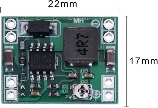

I'm a noob so please have patience with me. I have a 12V power supply to charge a motor driver, that I also want to power my Raspberry Pi-4B. I bought these mini buck converters on Amazon:
https://www.amazon.com/gp/product/B01MQGMOKI/ref=ppx_yo_dt_b_asin_title_o02_s00?ie=UTF8&psc=1
I adjusted the power supply to 12V and connected the +/- to the converter's IN. I then adjusted the out voltage of the converter down to 5.09v (closest I could get with the POT). Then I connected the converter's OUT to the Pi, + to pin 2 (5v) and - pin 6 (gnd).
When I turned on the power, the Pi started smoking and of course didn't power on. The converter has a max 3A, which is what I need for the Pi, right? So why would this setup fry my Pi?

The converter you have found is tiny and there is no way it could provide 3A. From the looks it could continuously deliver 0.3..0.5A, not more.

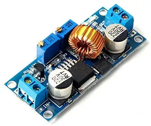

For comparison, this is how an actual 4.5A buck converter looks like:
When you connected it to the Pi, the converter got overloaded, and, having no overload protection (also not surprising for $1/piece module) it simply let 12V right though. This is what have killed your Pi.
