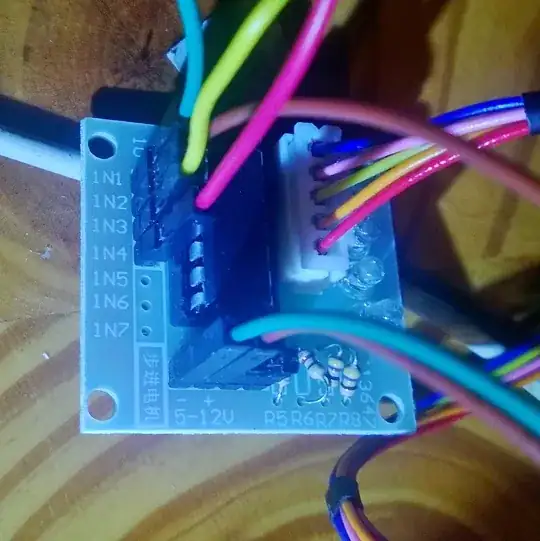

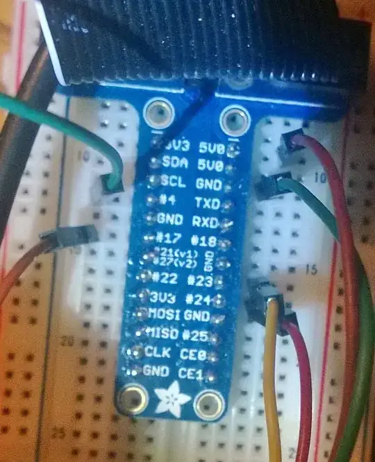

My breadboard looks like this enter image description here
My driver board looks like this enter image description here
I have
IN1 => GPIO 4
IN2 => GPIO 17
IN3 => GPIO 23
IN4 => GPIO 24

You need 3.3 volt to 5 volt bus drivers. The motor kit you bought was for Arduino which uses 5 volt gpio, the rpi uses 3.3 volts, just enough to trip the leds, but not work. you could also get a motor controller that accepts 3.3 volt control lines.
Remember always check your volt ratings!!

First, what power supply are you using? In the config I see, the same Vcc is used to drive the RPi, the motor and the board (jumper shorted). I'm surprised that doesn't reset the Raspberry (drawing too much from +5V tends to do that) but I really don't know the characteristics of the motor - so, maybe?
Can you get the stepper to move (minimally, single steps) by connecting +5V from the power supply to Red from the motor, and GND to remaining 4 terminals in sequence?
If the LEDs light up, and the motor doesn't move, it really seems like it's not getting enough current. If this is the case, either get a stronger power supply, or (recommended) add a separate PSU to power the motor - remove the jumper and in its place attach Vcc to outermost pin, and connect GND to the same line on the breadboard as the "-" wire (common ground, don't disconnect the one that's already there.)
(there is a small possibility that there's something wrong with the board too. Could you provide a good photo of the reverse side of the board? (solder side)?
SF.
  • 920
