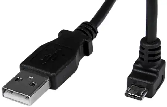

Just use the data port you can connect it to a USB audio device. You could also buy a similar device to the one you put above that you could connect to the Data port. If you're tight on space search for an "angled USB micro cable". You'll find something like this:
Angled usb micro cable
Another solution would be to use Bluetooth. Because it's a Pi Zero W, you'll be able to connect to a standard Bluetooth speaker.
