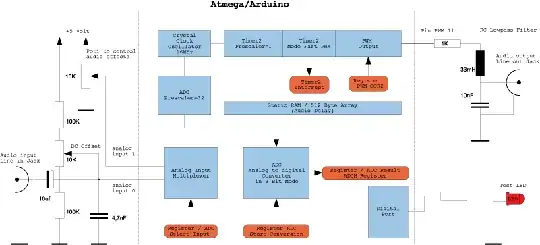

If there were some Analogue pins then you could use this Arduino project to help you out with the schematic.
