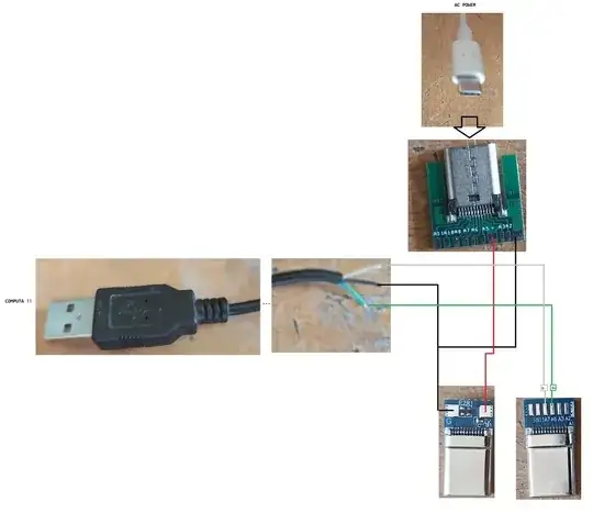

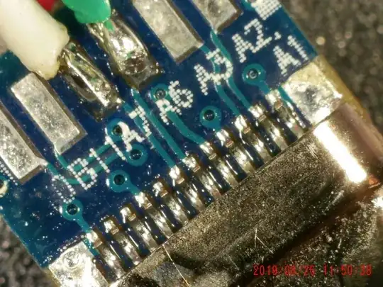

Note: I made the Y USB-C cable myself I guess it's working fine since Windows is seeing a usb device
thanks for the time you'll spend on this one
diy usb-c Y cable schema
