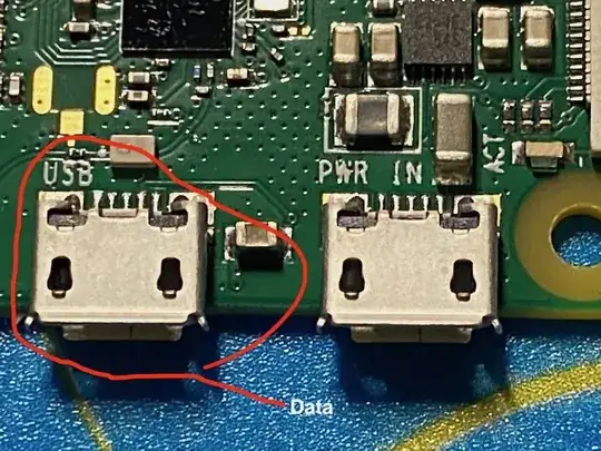

The Pi Zero has an additional USB connector (in addition to the one for Power, see figure below) that supports the functionality described in your link. The Pi4 has only one USB-C connector.
Pi Zero USB ports

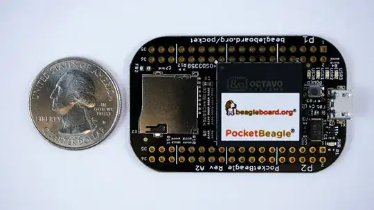

It further seems likely because Ethernet-over-USB has been around for about 20 years, and was built into the Linux kernel some time ago - this is not new technology! Also, there are several embedded devices that have been on the market for some time that successfully employ this technology - this "pocket Beagle" device for example:. Like the RPi it uses ARM-based SoC processor, but is built without serial ports, WiFi, BT or Ethernet; it relies on Ethernet-over-USB exclusively for all external communication. I have used this device, and know first-hand that Ethernet over USB works.
pocket beagle
