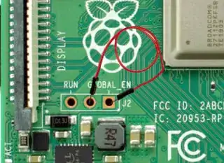

It seems that those pins can be used to start Pi 4, but I am not sure exactly how. Can a Pi 4 start after having been shut down by the shutdown menu, if I connect the two holes like below for a short moment?
For what it's worth, I have set the following configurations to reduce power usage when it is shut down.
BOOT_UART = 0
WAKE_ON_GPIO = 0
POWER_OFF_ON_HALT = 1
connect
PS: It does. I was afraid to try it because it might burn my Pi, but since no one was answering, I took the risk. I connected the 2 holes with an M-M jumper cable for a second, and the green LED began to blink and the Pi 4 booted.

The Organization's schematic is incomplete, but it does show GLOBAL_EN connected to U2 - the PMIC (Power Management Integrated Circuit). Pulling GLOBAL_EN low (aka shorting to GND) resets the PMIC - which causes it to power up all its outputs, in turn causing the Pi 4 to boot.
Your question is not completely clear to me, but when you say, "I am not sure exactly how" you may be asking, "How would one implement this feature - shorting GLOBAL_EN to GND?" If that's part of your question, there are several ways this could be done, but I know of nothing in the current Pi 4 hardware that would support this. One typical way this is done on other machines is with a RTC (Real Time Clock), but Pis have never had one. Another way would be with an external sensor of some type that provided a switch closure when some condition was sensed. Still another way would be to use a small microcontroller (Arduino for example) to set the state of GLOBAL_EN.
The documentation states:
POWER_OFF_ON_HALT
If 1 and WAKE_ON_GPIO=0 then switch off all PMIC outputs in halt. This is lowest possible power state for halt but may cause problems with some HATs because 5V will still be on. GLOBAL_EN must be shorted to ground to boot.
Default: 0 Version: 2019-07-15
If you've not seen it, you might want to read this answer, or if you want full details try this GitHub page.. Now we've both confirmed shorting GLOBAL_EN to GND will in fact boot the RPi 4 from halt, poweroff or shutdown when the EEPROM firmware is configured iaw the documentation.

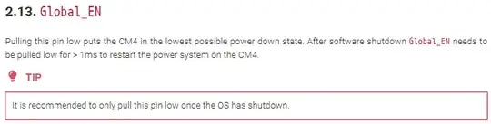

PI4 SOM spec on global_EN
In the specifications of the Raspberry pi SOM (CM4) it clarify that you need to pull it down for more than 1ms to reboot and you need to turn off the OS before to run it
