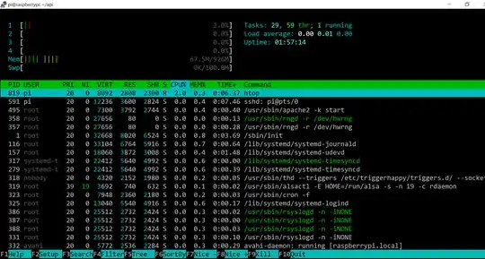

My htop is the following:
htop
Which looks like it's almost free of any task.

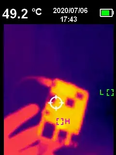

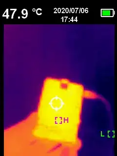

However it is pretty hot. I can barely hold my finger on SoC and network chips. My thermal imager shows this:
thermal img1
thermal img2
(Note that the dark squares on the top image are reflective surfaces - which always looks dark on thermal images)
Highest temperature is 51°C with ambient 28°C.

51 deg C is actually reasonably cool for a Pi3. My Pi4 regularly runs at over 60 deg C. Don't worry about it.
CoderMike
  • 7,102
Like others said, 50°C is reasonable. I would not worry too much.
