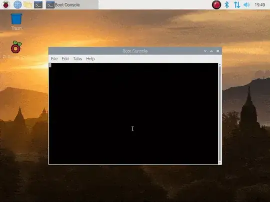

I've spent nearly a year perfecting a command-line tool for RPi called vdesktop.
It does exactly what you want - boot a RaspiOS image in a virtual container. As opposed to manual methods like chroot and systemd-nspawn, Vdesktop is the only tool that displays the container's entire graphical desktop.
Other unique features include sound syncing, clipboard syncing, and the ability to boot from attached SD Cards and .img files.
Here's my vdesktop repository: https://github.com/Botspot/vdesktop
And below is a GIF showing the entire boot process: animated
