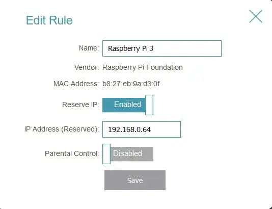

  • Remove reserved IP for RPi on the router
