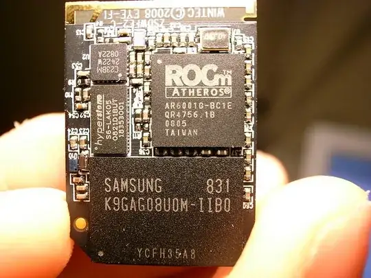

A peculiar little device. You cannot really find anywhere how it works internally but what i can tell you is that its a normal flash drive. No setting files are stores on the flash memory it self! The special part it that the S6 chip also acts as a MCU and and communicates with the Wifi chip using it UART :-)
When you use the "utility" it actually communicates with the SoC via a 1SPI line? i suspect/ which is used to setup your WiFi settings. The settings are likely stored in the S6 flash- its only a bit of text.
Then, on power up the independent firmware on the S6 polls the SD Card and uses it own code to send them over your wifi to their service.(2I think it will support major file formats,except NTFS because of copyright limitations)
I can bet you 10quid that the web service address is hard codded and un-hackable (unless you got the source code and re flashed it)(or reverse engineer the HEX and find the service in unencrypted plaint text string un re upload it without bricking it)
End of the day. NO You cannot use this to do traditional WiFi communications because there is another micro system that runs independently of everything. If you designed your own SD card and exposed an API for basic TCP communications. Who knows- everything is possible.

I don't think this will work. From what I can gather, the SD card consists of a single FAT partition, which is synced with the cloud when you take a photo, ie you can't flash a OS onto it and it doesn't allow arbitrary WiFi traffic.

My guess would be that the Wifi part of the card is controlled by its own microchip and isn't accessible from a card reader/computer. As others have mentioned. It probably reads a settings file configured by the windows application, which automatically does the Wifi bit as a stand-alone process, not interfaced against the SD card pinout at all.
William
wifi chip probably has it's own CPU and RAM. That "memory" controller probably boot up wifi chip since it got access to flash and I'm sure there is some part of flash which is not used for FAT data partition
