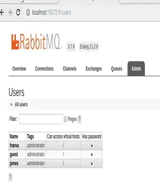

I followed this link to install RabbitMQ server on my Raspberry Pi 4.
I can see that RabbitMQ 3.7.8 and Erlang 21.2.6 are installed.

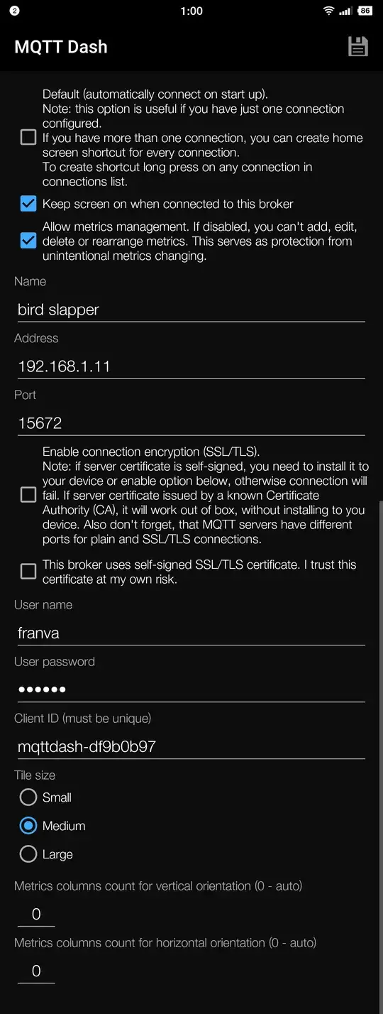

But I cannot connect to the server from a client (Mqtt Dash, Android app) enter image description here
Can someone share some ideas?

I have run the above commands to enable and start the mqtt and tried both 1883 and 8883 on the Mqtt Dashboard app, still have no luck.
