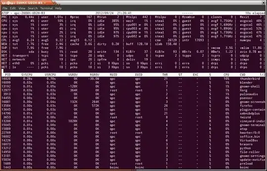

Consider installing atop for diagnostics. When the atop service is running, it periodically logs the machine's state to a file for later debugging.
I think atop defaults to every 10 minutes, but you could drop this significantly to help identify what processes are consuming CPU/IO/memory by stepping-through some top-like screens.
From https://www.linuxlinks.com/atop/
from https://www.linuxlinks.com/atop/
