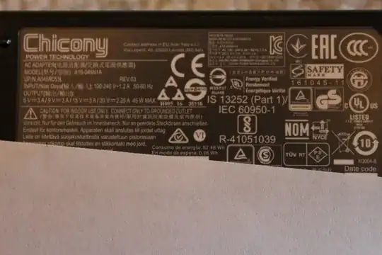

What does it mean when my acer chromebook 11 charger says "5v ⎓ 3a / 9v ⎓ 3a / 15v ⎓ 3a / 20v ⎓ 2.25a" on the ac adapter? I want it to output 5 volts with 3 amps, but I am confused at why it also has the other options afterward. I am thinking about using this for my Raspberry pi 4b. Will this sub for the offical power supply?
Thanks in advance!
EDIT: Here is the image of the ac adapter: enter image description here
It seems this is an auto-charger. You should not use this types of chargers to work with Pi. If accidentally the the voltage rise your Pi would fry.Use a 5V 2.5A adapter if you can manage.

3 amps at 5 volts should be enough to power any Pi.
Whether your charger can produce this or not is impossible to answer without the actual charger or clear photos.

This means, that the charger can work in any of this options. The default option is usually one with the least power (3V/3A in your case). Then the charger is connected to the device, they can communicate by data wires and, if necessary, increase the power (obviously, by request from the device).
totikom
  • 101
The higher voltages on your power supply should only be activated after USB-PD negotiation has taken place. USB-PD stands for USB Power Delivery which is the official standard for the negotiation of power delivery over USB. The Raspberry Pi 4 does not support USB-PD and therefore will not negotiate to a higher voltage. I can't guarantee anything, because I couldn't find if the power supply supports USB-PD.
If it follows standards, it should not go over 5V and work just fine for your Raspberry Pi.
