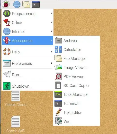

Best option is a complete clone of your SDCard as a bootable backup.
There's a tool in Raspbian to do that, all you need is a USB reader and a second SDCard that's the same size or bigger than your current SDCard.
SD Card Copier Tool
