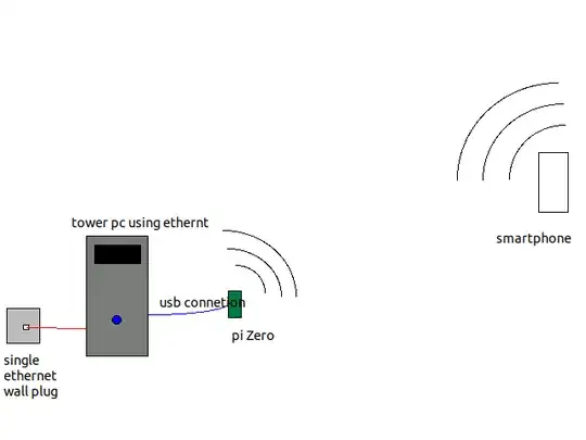

I have a Ethernet connection in my room but the WiFi from the router in the basement is not available here. However my tower PC is connected via the one single Ethernet connection anyway.
As I have a Raspberry Pi Zero W laying around I was wondering if it would be possible to plug the Pi Zero via USB to my PC and let it create a wireless network only for my room (something like an access point) that will route the data from my PC (which is obviously using the Ethernet connection) to the pi using its USB connection to the PC.
I would like to connect my smartphone to a wireless network in my room without buying new hardware.
I attached a primitive painting to explain what I am looking for.
possible?

There are mainly four steps to do:
  1. Create an ethernet connection over USB using OTG gadget mode
  2. Create an access point on the RPi Zero W
  3. Route traffic to the tower PC, recommended with Network Address Translation
  4. Setup routing or configure a bridge on the tower PC
Point 4. is out of scope here on Raspberry Pi, so I will look at the other points.
  1. To connect the RasPi by USB but have an regular ethernet network connection emulated, you can use OTG gadget mode. Then you will have a regular network interface usb0 that can be used like any other network interface, for example like eth0. Before continuing setting up the RasPi as access point you should ensure that you can connect to the RasPi from the tower PC with ping and ssh.
  2. and 3. You can look at Setting up a Raspberry Pi as an access point - the easy way following section ♦ Setting up an access point and with eth0, with NAT (recommended). Just replace everywhere interface name eth0 with usb0 (or what your interface name is from the usb connection).
