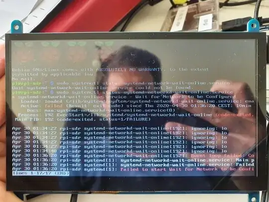

First of all it hangs and eventually fails on systemd-networkd-wait-online.service:
But after a while I can log in.
sudo systemctl status systemd-networkd-wait-online.service shows this:
There was a solution given here, so I tried
~$ sudo systemctl edit systemd-networkd-wait-online.service
and then add the slave devices of the bridge
[Service]
ExecStart=
ExecStart=/lib/systemd/systemd-networkd-wait-online --ignore=wlx00c0ca66080c --ignore=wlan0 --quiet
but that didn't seem to help.

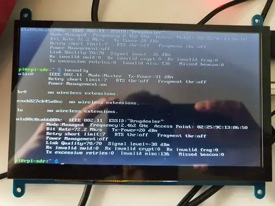

However, two things do work: wlx00c0ca66080c connects to Drugdealer and wlan0 creates an access point Drugdealer-terras. But br0 doesn't get an ip address, so when connected to Drugdealer-terras I don't get an ip address either.

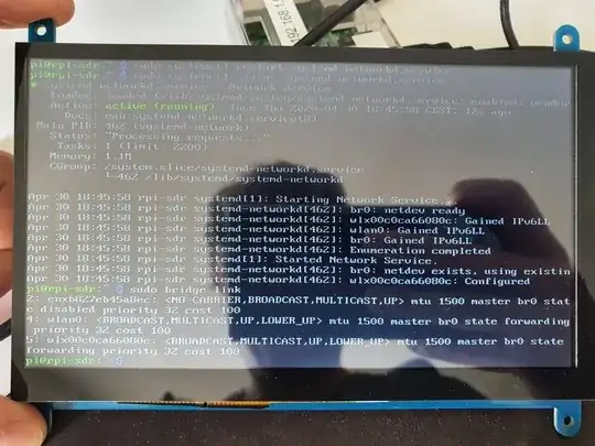

sudo systemctl status systemd-networkd.service
The error reads: wlx00c0ca66080c: Could not join netdev: Operation not supported
iwconfig

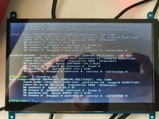

ifconfig

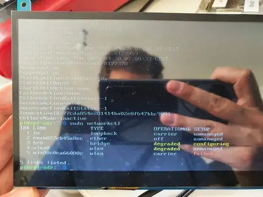

networkctl

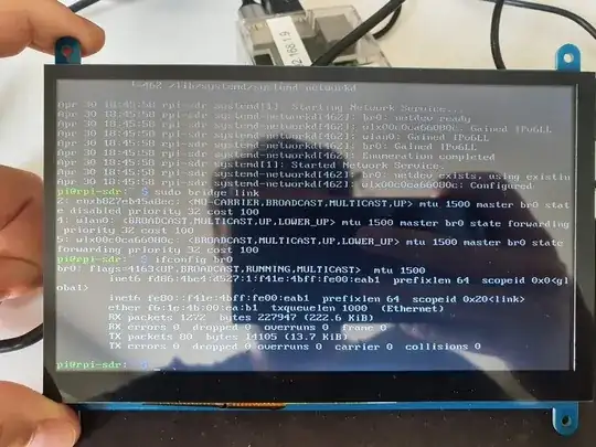

1. I have made the ethernet interface part of the bridge. The bridge now gets an ip address and at least I can have ssh access if I want. But for the rest of the tests, I have the ethernet disconnected. 2. Several sources (1 | 2) point towards enabling 4addr for the wifi interface. When I do sudo iw dev wlx00c0ca66080c set 4addr on and sudo systemctl restart systemd-networkd.service, I see that wlx00c0ca66080c becomes part of the bridge:
sudo systemctl status systemd-networkd.service and sudo bridge link:
But ifconfig br0 shows no ip address:
