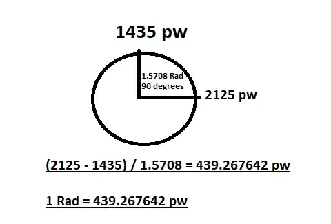

the answer that joan gave does give an approximation of where the angles are, but the more you go from centre the less accurate it is, at the end to get a perfect relation between the exact angle and the exact equivalent in pulse width I used a simple rule of 3:
I basically put my motor in the exact centre (in my case 1435), then I kept manually adding pulse width until the motor was at 1.5708 radians (90 degrees), in my case that is 2125 pw, so now we know that 2125 - 1435 (690) is exactly 1.5708 radians (90 degrees), which means that
1 Radian is 439.267642 (690 / 1.5708).
now I can easily give any angle and get exactly how many radians that is
 def ConvertRadsInPulseWidth(angle):
    everyRadianInPulseWidth = 439.267642
    rounded = "{:.10f}".format(float(angle))
    pulseWithFromRadians = (everyRadianInPulseWidth * float(rounded))
    moveFromCentre= 1435 + pulseWithFromRadians
    return moveFromCentre
