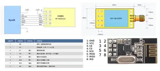

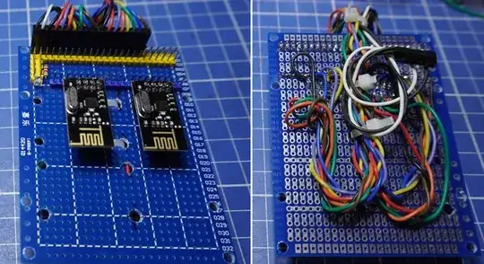

rf module 1
rf module 2

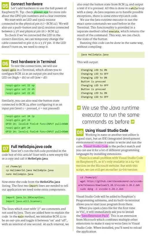

(5) Now I am following the BlueJ and Pi4J tutorials (Refs 8 ~ 14) to do my newbie Java GPIO and SPI programming exercises.

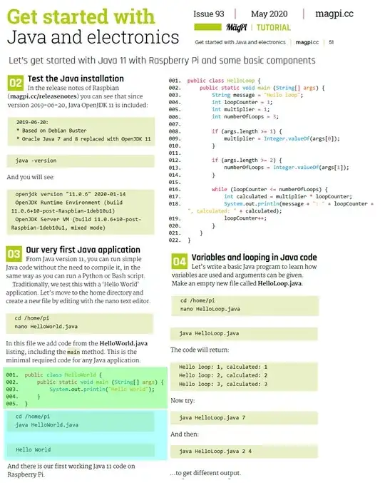

ERRATA

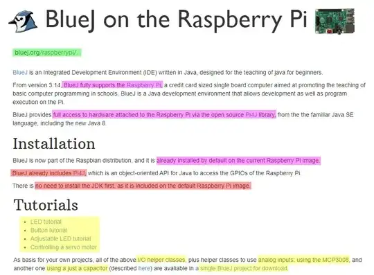

I found the tutorials referred above are much out of date. So I googled harder and found a couple of very up to date tutorials, and other too good to be true things including the following:
(1) BlueJ already includes Pi4J, therefore no need to install.
(2) Rpi buster already includes JDK, therefore no need to install.
(3) BlueJ also includes GPIO classes for Rpi.
(4) BlueJ already includes tutorials on LED, button, servos, analogue sensors, including MCP3008.
In other words, my tentative plans in Sections 1 to 4 above are all rubbish!
bluej rpi

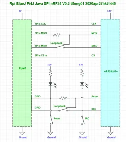

(6) If BlueJ already includes Pi4J which in turn includes SPI, I think they are very mature or stable and should have very little teething problem, so is not much need to do any feasibility study. In other words, we can just do a incremental/continuous TTD (Test Driven Development) starting from the very bottom, GPIO control of the NRF24 Reset and Interrupt pins, using BlueJ's LED and Button tutorials as a reference. Here is a top down schematic of the overall test plan.
nrf24 schematic

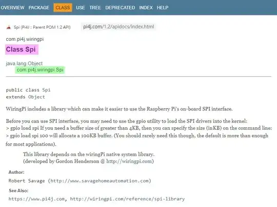

(8) Now I am reading the Pi4J SPI Class. The documentation looks good:
pi4j spi class

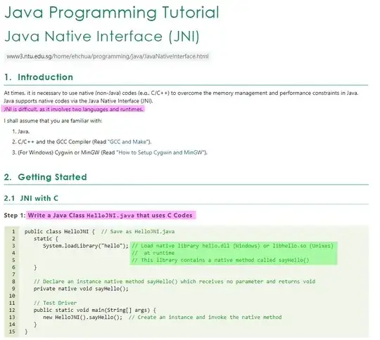

(9) Java JNI learning notes
JNI
