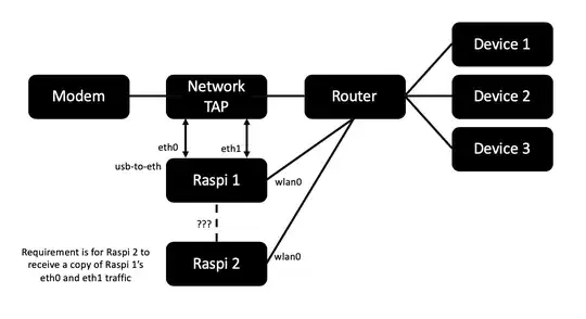

  1. In the below setup, Raspi 2 (3B) needs to get a copy of the TAP traffic from Raspi 1, for both eth0 and eth1, preferably without an additional switch.
    I have another spare usb-to-ethernet adapter. Do I bridge both interfaces? IP-forward traffic? Use a software to mirror traffic? If anyone could provide detailed explanation, that would be very much appreciated.
    The rationale for such a setup is to test and compare some softwares.
  2. A second question would be, if there is a more efficient way to have a raspi cluster share that TAP network feed with different tools on both raspis, I would love to hear that as well!
setup
I am currently trying:
iptables -t mangle -A PREROUTING -i eth0 -j TEE -gw <raspi2>
But either "multiple -j flags not allowed" is thrown, or "gateway is an unknown option" is.
George

First attach the spare USB/wired ethernet dongle to RasPi1 so you have interfaces eth0, eth1, eth2 (the dongle) and wlan0 on it. On RasPi2 you just have its built-in interfaces eth0 and wlan0. Connect the two RasPis with an ethernet cable. To configure the network I will use systemd-networkd because it has all things available and simplify setup a lot. We can just configure it and don't need additional helpers.

Please note that there are no ip addresses on the wired interfaces. After reboots you should be able to watch all traffic on the broadcast domain (merged interfaces) from all interfaces, e.g. with tcpdump:
rpi1 ~$ sudo tcpdump -n -i br0
rpi2 ~$ sudo tcpdump -n -i eth0
