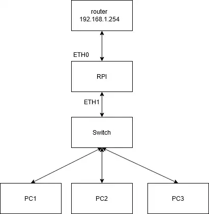

I am having issues finding the correct approach to take with my RPI setup. I have a router that does not let me disable DHCP and subsequently wont let me modify the DNS associated.
I would like all machines connected to my RPI via a switch connected to eth1 to use the same DNS.
What I have done so far? I am able to setup a bridge between eth0 and eth1 like so:

here is a rough diagram, (minus the no connection part on the pc, as it now works):
Any help would be appreciated.

I will explain in short how a DHCP server works together with a DNS server to show what is possible for your problem. A network client requests an ip address from the DHCP server with its network name. So the DHCP server knows name and ip address of the client. It gives this information with DNS update records to the DNS server, but it must know what DNS server it has to inform. This is by configuration. If you cannot reconfigure this setup, you are lost with it.
Therefore I would completely separate from the DHCP server on the router and use an own DHCP server on your local network. Because DHCP server only work on broadcast domains (single or bridged subnets) there is no problem with conflicting of two DHCP server if you use routing. For example you can use subnet 192.168.1.0/24 on eth0 for the router and 192.168.2.0/24 on eth1 for your local network. Setup routing between these two interfaces is a well known task. Then you can install your own DHCP server and DNS server on the RasPi to serve on eth1 for your local network. dnsmasq is a good choice for this. It can do DHCP and DNS (and more) in one.
