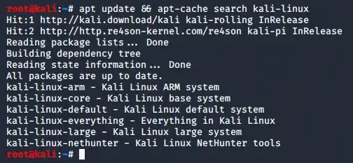

Run the following command:
apt-get update && apt-cache search kali-linux
You should see the list of metapackages you can install.
If kali-linux-everything is listed, try running:
apt install kali-linux-everything
