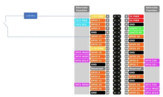

I set up a simple curcuit and tried a pullup and a pulldown scenario, but both lead to a lot of "false positives". Currently I ended up with the circuit you can see in the image. I have no button attached, but jumpingwires i connect and disconnect to a breadboard. Even when I don't connect it there is a level increase.

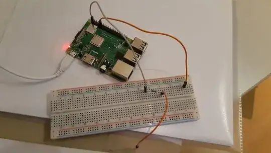

Here is a photo of the setup (I use the orange jumoing wire to simulate the switch)
Update 2: I found a hint why there might be a problem. Therefor I had to modify the script a little bit as you can see above. When I now run the script and connect/disconnect the jumping wire periodically, I see that sometimes (but not always) there is false "rising" detection when I disconnect the wire. This seems to be a common issue since 2014?

There are numerous errors in the script.
  1. time module is not imported
  2. PIRinPin is not defined.
  3. AmountMotionsDetected is not defined, set as a global, or incremented.
Once those errors are corrected the script works properly.
Therefore you have connected to the wrong GPIO or you are using very long wires.
WoJ
  • 543
I would start by debugging this on the command line using gpio. gpio readall can tell you if the pin gets configured correctly, and whether it changes the state. See if the pin changes state when you pull it to 3.3V / GND via a resistor. When that works, get back to your code and see how it behaves. Once it works, switch to an internal pulldown.
  • 28,277
  • 147

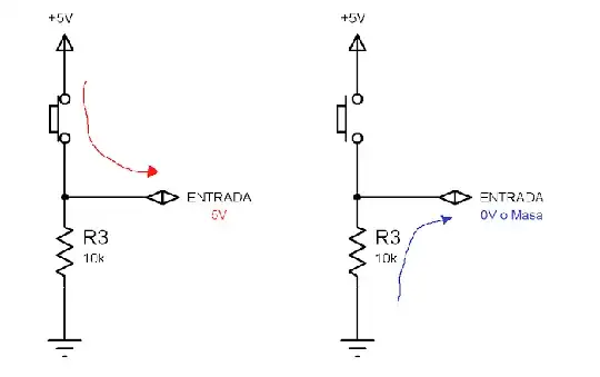

Been in the electronics 30 years, never saw a so poorly designed input circuit. First thing first, never bring vcc (regardless it is 3.3 or 5v) to a input jumper ! Your jumper should be between ground and input. With a pullup, and use a 10khoms pullup not 220R !
Also debounce input reading algorithm goes like this (low level) 1. Read state 2. Compare previous state 3. No change ? Reset counter to whatever 4. Change ? Memorise new state, decrement counter 5. Only when counter reach 0 (reading it n times SAME state) then proceed with piece of code
Your pull up connection is wrong in the image you can see the correct connectionenter image description here
