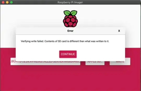

I am trying to image Ubuntu onto an SD card on my Mac for use with my Raspberry Pi 4 using thew new official imager tool from Raspberry Pi (found here: https://www.raspberrypi.org/downloads/). For whatever reason, every time I try to image any version of Ubuntu that is pre-selected from the Ubuntu OS Menu (v18.04.4 32 & 64 bit, v19.10.1 32 & 64 bit, and Ubuntu Core 18 32 & 64 bit), it completes the install, but at the verify stage it fails once it reaches 100%. Specifically, the error message reads "Verifying write failed. Contents of SD card is different then(than?)what was written to it." I know that the imager does work. I got it to install Raspbian without issue.
Moreover, I have tried downloading the .xz file directly from Ubuntu (v18.04.4 LTS - https://ubuntu.com/download/raspberry-pi) and using the RPi imager with that file. It gives the same error message. I have also tried unzipping the file and using the .img file with the imager and it gives a different error saying Error writing file to disk.
So, the question is why won't it install Ubuntu? Since this installer is under 2 weeks old, I have not found much information elsewhere.

Below is the error that pops up. Verify Fail Message

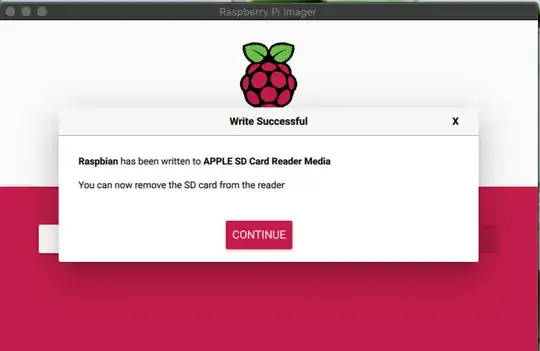

A successful install message (in the case of Raspbian, for example) should look like this: Successful Install Message

I find the Raspberry Pi Imager fails to verify about 20% of the time. I have no explanation as to why but repeating the process with the same SD card and balenaEtcher produces a working install. I usually flash large (128GB) cards which may or may not be a factor.

UPDATE it seems for some reason the imager wont verify on the pi itself i am only having success when i run these operation on my laptop using kali linux and the raspberry pi imager. i was also successful with kali linux os on the pi 4g using this process as well as ubuntu mate.

Try other PC once, please.
In my case, always failed to verify with my desktop (Win10 pro, 64 bit), but no problem on my notebook (Win 10 pro, 64 bit).
I suspect that this problem is related with SD card reader driver.
