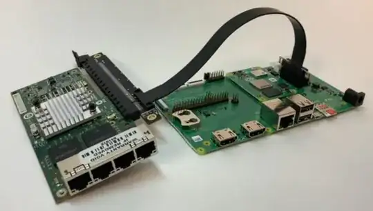

FWIW, if you have a Pi CM4 with the IO board (as opposed to a regular Pi 4), you could add a PCI Ethernet NIC (with multiple ports), by using the on-board PCI-E slot, to make a multi-homed device.
The official IO board already has an on-board gigabit Ethernet port, so by simply adding a dual NIC PCI card, you would then have the three Ethernet ports that you want. The main advantage of this approach would be that all of the ports will operate at full speed, when compared to using the slower USB-Ethernet dongles described in some of the other answers.
One such example is shown in Jeff Geerling's video, 5 Gbps Ethernet on the Raspberry Pi Compute Module 4?!, which uses a 4 port, Intel I340-T4 PCIe NIC.
CM4 IO board with 4 port NIC attached
A combined speed of ~3 Gbps was achieved.
Jeff also touches upon using USB-Ethernet dongles - merely to state that the PCI solution is much neater.
