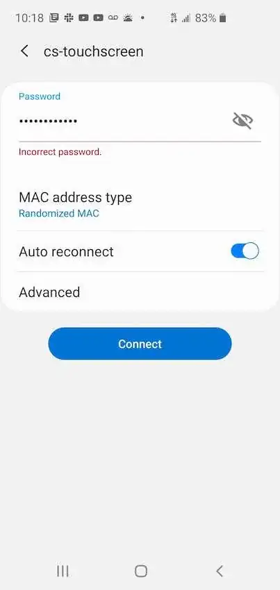

I'm trying to set up my raspberry pi 3 running a fresh install of raspbian buster as a wireless access point with a bridge to ethernet to give connected devices internet access.
I followed the official raspberry pi tutorial for doing so found here: https://www.raspberrypi.org/documentation/configuration/wireless/access-point.md
As I walked through the tutorial I was able to connect my phone and laptop to the access point before I added the ethernet bridge. After adding the bridge section everything shows up fine in the logs, but for some reason when I try to connect from my phone and computer now I get "incorrect password".
I did not change the password in my hostapd.conf file between each section so I know the password is correct considering I was able to connect to the AP before the bridge.
I did some searching around and found this thread that says the issue may be due to a timeout that triggers when the translation of the password from the plain text to hash takes to long and suggests replacing the wpa_passphrase with a wpa_psk using a hash generated by the wpa_passphrase command. I tried that and get the same "incorrect password" prompt.
I'm not sure what to do from here or how to troubleshoot it.

The computer I'm trying to connect from is an apple running mac os 10.14.6 and my phone is a samsung galaxy s10 running android 10.
