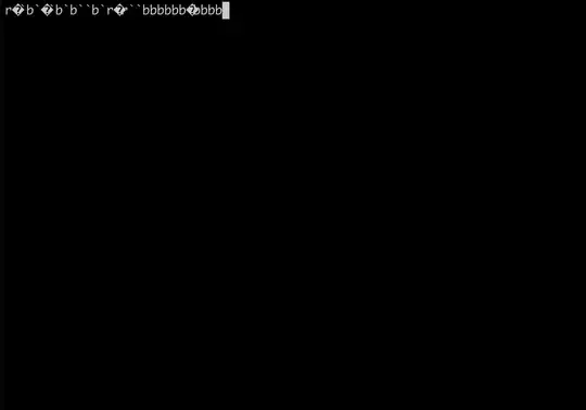

U-boot logs are coming fine on HDMI , but I get garbage characters on Minicom (set at 115200, 8N1).
I am using the FTDI 232R-3V3 cable and have connected the RX, TX and GND on pins 6, 8 and 10 (criss-cross connection). HDMI port is also connected.
What could be the reason for this? I read here that BT operation could interfere, but I am not sure if that is applicable to me since I am not using Raspbian and only loading U-boot. If this is the case, how can I fix it? What other things I can try apart from mentioned at the top?
EDIT
This is how the garbage characters look like. So when i type, some random character k pops up, when type x, ` may come up. Otherwise output remains blank: enter image description here
