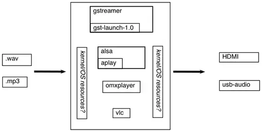

The image below captures my understanding of the various alternative paths from sound files to audio output.
(i see mentions of pulseaudio around others; does it impact gstreamer? should i include it in the picture?)

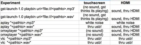

i've tried 7 different experiments, and also varied touchscreen vs. HDMI display options. Result summary:
the vlc experiments show that it is able to get to usb-audio in both cases. aplay with the touchscreen is also able to send sound to usb-audio. (my current guess is that aplay is missing some mp3 codec and barfing out noise?)
clearly there are lower-level (kernel? raspbian?) resource paths that i don't know about. how can i make gstreamer consume whatever resource it is that vlc and `aplay are able to use to get to usb-audio?
