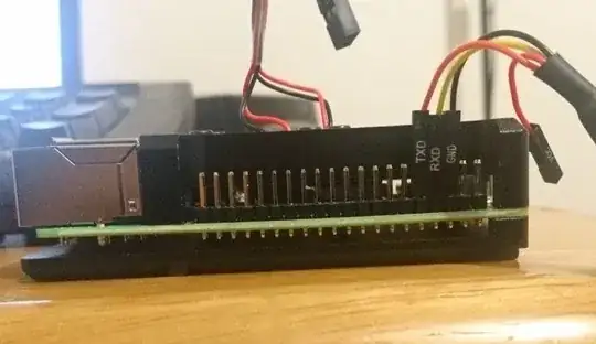

My config.txt has:
dtoverlay=pi3-disable-bt
enable_uart=1
at the end and my cmdline.txt has:
root=/dev/mmcblk0p2 rootwait console=tty1 console=ttyAMA0,115200
And here's how I've connected it:
I followed this based on some other examples on this site. But when I connect my picocom exits saying FATAL: cannot open /dev/ttyUSB0: No such file or directory and I see these error on my syslog:

(I think, I may have fried my serial cable).
What is the correct way to open the serial console from a Linux desktop?

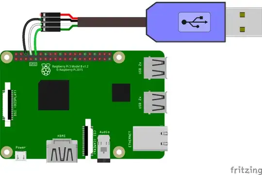

First a complete picture with "official" colored wires. enter image description here Thanks to fiery for providing this picture to connect an USB to TTL serial adapter.

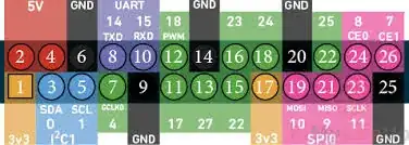

As shown in the pinout you have mixed up TXD (pin 8) and RXD (pin 10). Maybe it is the reason why your adapter get hot?
pinout
