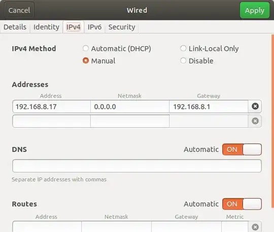

Here is info about wired connection from the laptop on the screenshot below
enter image description here]

The Pi and the laptop are on different networks. I suggest setting a static address in the 192.168.8.0/24 subnet on the Pi. You'll need to use one that hasn't been assigned by the DHCP server on your network.
Alternatively, since it seems that the laptop's address was set manually, you could set an address in the link-local network (169.254.0.0/16) on the laptop. Possibly all you need to do is click that "link-local only" button.
The first two or three numbers in the IPv4 address must be the same for two computers to communicate without routing. Wikipedia has an explanation of subnets.
