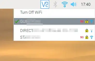

Without static IP odefinition in /etc/network/interfaces wifi working

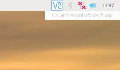

With static IP odefinition in /etc/network/interfaces Wifi not working

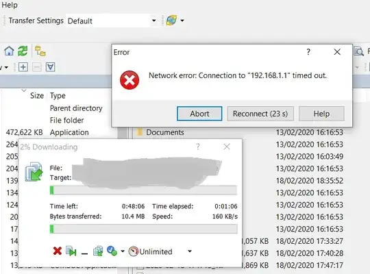

Network failing halfway file transfer enter image description here

I have tried disabling all other network adaptors both in window side and on Raspberry Pi side. I can consistently make the network to fail (ping will stop, ssh would fail, etc..) by transferring a large file with WinSCP. Connection recovers if I unplug/plug the USB adaptor on the windows side.
