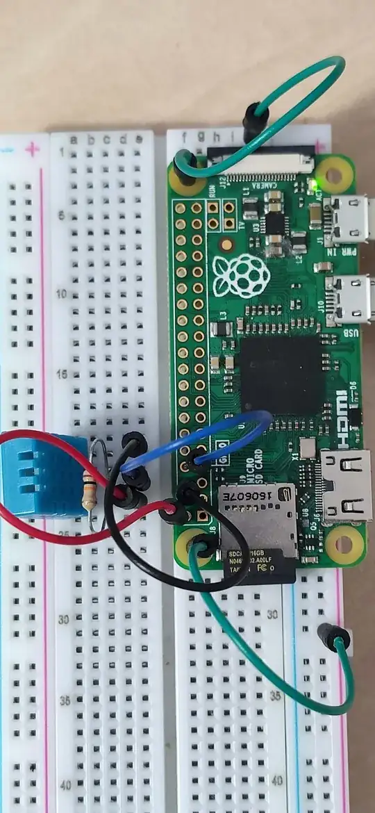

I have RPI Zero with DHT11 connected as recommended (diagram) and I was reading data from it with ~90 % success rate every 5 minutes using the old Adafruit library. But today morning it stopped receiving data so I tried to troubleshoot it using new Adafruit library and it seems like there is connection issue:
DHT sensor not found, check wiring
Notes:
  • I am using 10K resistor.
  • DHT11 is connected to GPIO4 (pin 7)
  • I was able to measure voltage changes on the sensor, so I believe the wiring is OK

However, I did not move any parts so it seems like the sensor is dead?
How can I troubleshoot it?
