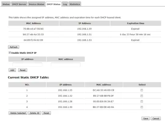

  • I have setup a static IP lease on the wlan0 & eth0 MAC address

PER THE COMMUNITY'S FEEDBACK THE STATIC IP WAS CHANGED TO DHCP

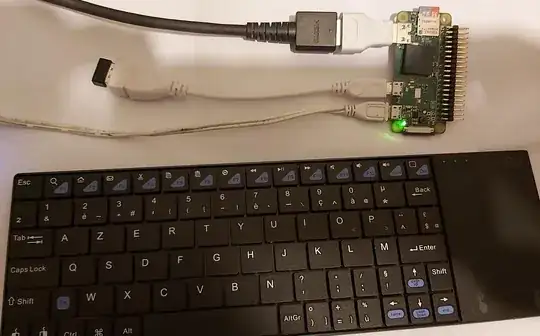

  • I unplugged the eth dongle
  • I use a monitor on the HDMI output

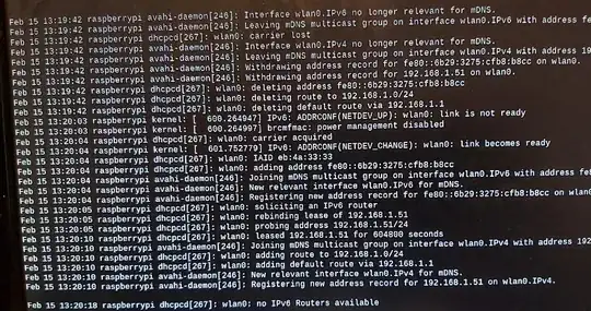

  • I checked dmesg, /var/log/messages, and /var/log/syslog. this is what happen when running sudo ip link set wlan0 down/up
(I dont see any relevant info, I'll now create a new sd card)
