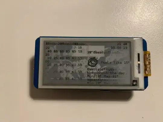

There is a ghost image (not sure if that is the right term) on my e-ink display from waveshare:
Is there any way I can fix this, or do I have to replace the display?
The ghosting appeared after several days of use and I think it appeared because I didn't put the display to sleep after updating it. Can anyone confirm that adding the .sleep() call would prevent this to happend again?

To stop this happening you need to run a 'scrub' cycle frequently. Each day (well early morning) I run a cron job that sets all the pixels red, then black then white (I have the Pimoroni display) including the display frame / edge.

As your screen has been 'set' for a while, you may want to add a delay of a minute or so between each colour change and run the scrub a few times while checking on it.
The cause is due to the discharge not being complete and leaving some cells 'stuck' in part charged states - hence the ghost image.
The recommended procedure preventing ghost images on e-ink is to fill the display with 100% black, then 100% white, then display the target image:
If this is what you already do, then you just got a low-quality display.
