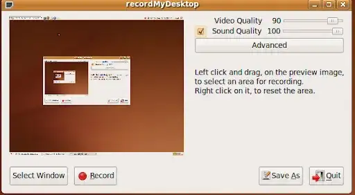

recordMyDesktop is here for you. It captures what you are watching on the screen and also saves all audio input/output.
You can use it by the terminal and also it has a GUI like the image below:
Update repository:
sudo apt-get update
Install the package:
sudo apt-get install recordmydesktop
Start recording/capturing:
recordmydesktop myCapture.ogv
To stop the process hit Ctrl + C and then it will save a .ogv file in the current path.
More configuration on man page of this package.
