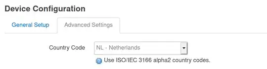

I found out that my wlan0 was disconnecting due to country mismatch on a router and board itself.
Once I set them both to matching, disconnects vanished.
Router setup: OpenWRT configuration supplementary image
And wpa supplicant config:
country=NL
ap_scan=1
passive_scan=1
network={
