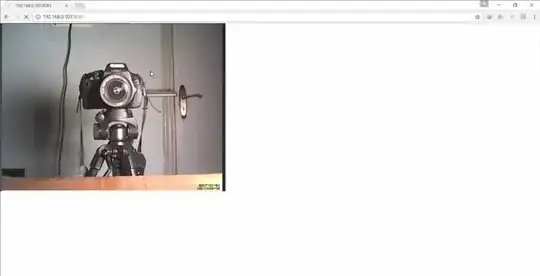

The motion is here for you. It has a web interface that you can see the camera's stream in real-time.
How to Make Raspberry Pi Webcam Server and Stream Live Video || Motion + Webcam + Raspberry Pi

In conclusion, after all of this two sections you can connect to raspberry pi's SSID (Wifi name) and open a web page to see the real-time streams.
