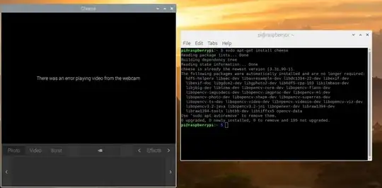

I have been trying to run my 4WD Smart drive car with raspberry 3. I am using python 3 to implement algorithms and computer vision object detection. I also have a problem with Cheese camera on the pi.
I have install this:
sudo apt-get install libhdf5-dev -y && sudo apt-get install libhdf5-serial-dev -y && sudo apt-get install libatlas-base-dev -y && sudo apt-get install libjasper-dev -y && sudo apt-get install libqtgui4 -y && sudo apt-get install libqt4-test -y

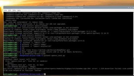

 pip3 install opencv-python
pi@raspberrypi:~ $ python3 -c "import cv2"
pi@raspberrypi:~ $ python3 -c "import numpy"
$ cd
$ git clone https://github.com/dctian/DeepPiCar.git
cd DeepPiCar/driver/code
 python3 opencv_test.py
To do this I have used the following code: see attachments

I cannot read the text on the pictures but I suppose from your title that you just want to install OpenCV. We have seen many problems here on this site trying to install OpenCV with pip. OpenCV is part of the default Raspbian repository so you can just install it with:
rpi ~$ sudo apt update
rpi ~$ sudo apt full-upgrade
rpi ~$ sudo apt install python3-opencv
Maybe you will also need python3-opencv-apps.
This installation is tested and should fit best to your operating system without errors.
