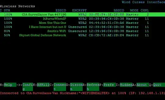

1. Install wicd-curses:
sudo apt-get install wicd-curses
2. To start the wicd-curses:
sudo wicd-curses
Then you would see a config menu like it:
If you get a message saying that no networks detected, press P (must be capital so use Shift+P) and type in wlan0 in the wireless interface field and press F10 to save.
3. Press Shift+R to refresh the list.
4. Choose the SSID and hit the Enter button.

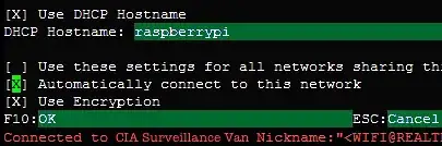

5. Enter the password and make the "Automatically connect to this network" checked.
6. Hit the F10 to save.
