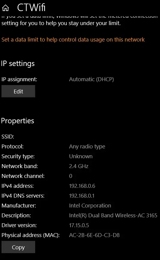

However, I am not able to ping or ssh the Pis from my laptop. It seems that there is no IP address allocated to my laptop so I assume that the DHCP server is not working.
no IP address when connected to ad-hoc network

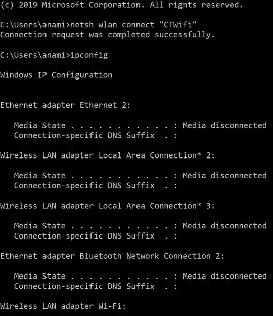

When I connect to the network, my computer does not have an IP address designated to it, so I assumed the DHCP server is not working

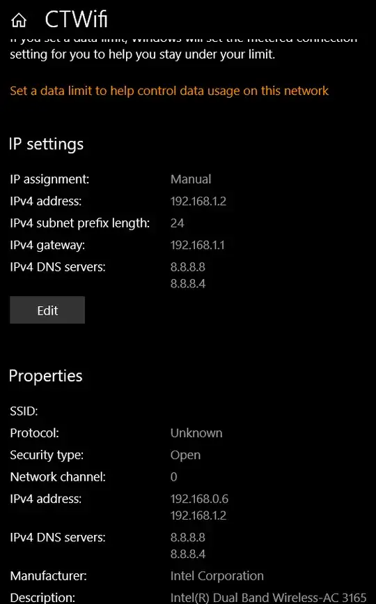

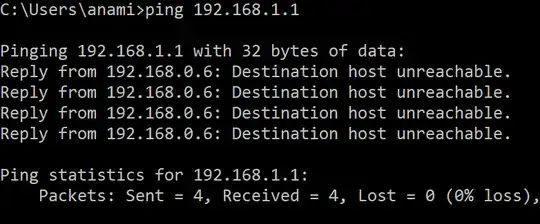

When I attempt to the ping the Pis, it seems to keep the old IP address from the previous connection (192.168.0.6 , my own Wifi connection)
The settings are configured to have the IP address automatically allocated by the DHCP server, but it is not working, so I tried to set it manually, but it still keeps the old IP address and the manually set one.
