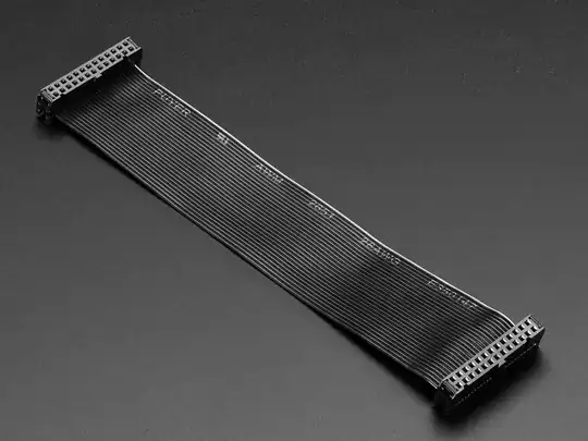

Hello I am in need of a ribbon cable for my custom pi hats. The problem with ordinary ribbon cables such as this

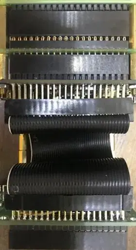

I could not make it to align the rows of the pins will get swapped because of the cable. Here is an image of what it should look like
But in the image it is not obvious that the pins are not being connected the correctly. the Top row pins which is the visible gold pins where the ribbon is attached is actually being connect to the bottom row pins(not visible because of camera angle) of the other end of the ribbon.
I have tried to undo on end of the cable assembly and rotate in all possible combination and attached it back to the cable but still i am not getting proper result?
Any ideas?

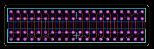

It seems that it is not possible with common ribbon assemblies. Instead i just made and an adaptor board as suggested by @tlfong01
This is currently its PCB footprint would look like and would use right angle female headers and ordinary male headers. The ribbon would attach to the male headers and the female headers will go to the bottom of the hat.

They way ribbon cables work is this... If you're connecting to the GPIO pins on the Pi, they're on the top of the PCB. A HAT which connects to it has pins on the bottom to mate with the Pi, and they are located to allow this to happen. It's hard to understand from your question, but I'm guessing you're trying to use the ribbon to connect to the female connectors on the bottom of a HAT (perhaps by using a header in between to act as a male-to-male adaptor). The ribbon cable is designed to connect a connector on the top to another on the top - and can't be used to connect a top connector to a bottom one.
