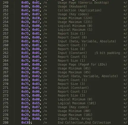

Looking at the official document from the USB org, boot keyboards require support for SET_PROTOCOL and GET_PROTOCOL requests from the host (Appendix B.1 and F.3). I did modify the report descriptor as shown in Appendix B.1.

Fyi (this is the descriptor cited by 1):
