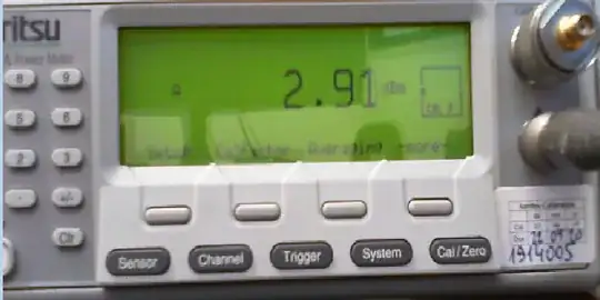

unfortunately i get only 3 dBm output power. If i send the same commands from a PC i do receive 10 dBm as expected also if i send:
>>> instr.cfg
<CONFIGURATION 1: 400 mA>
i connected the Signal generator through a USB hub with a power supply to avoid any power consumption issue but still have the same result. Your help is very appreciated . Thank you!
P.s. picture is added: enter image description here

The issue was resolved by sending *RST command. It seems that the signal generator wakes up in some strange mode (BUG). *RST fix it.
