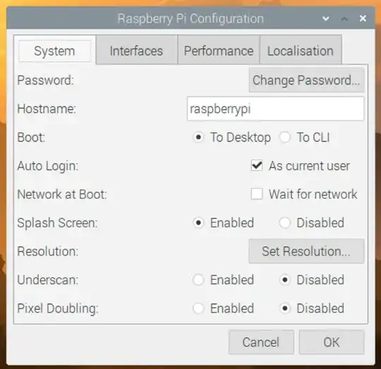

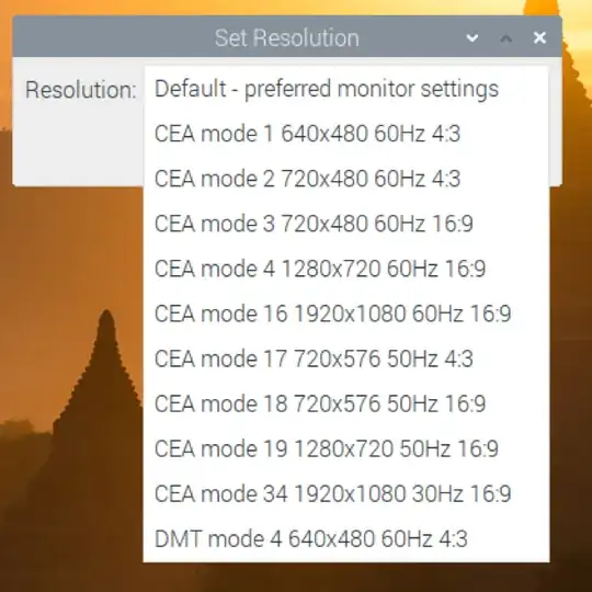

In 'Raspberry Pi Configuration', select 'Set Resolution'
Choose resolution, then reboot.
