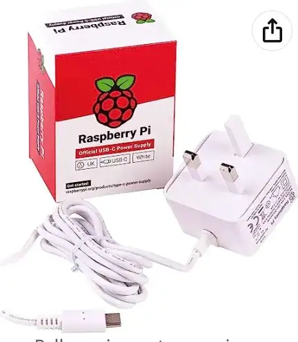

Your guess is correct. This is something that appears regularly on Raspberry Pi forums. The Rpi 4, like the other models, can supply 1.2 A total to all USB ports (Rpi5 can do 1.6A if settings are correctly altered). That is, the maximum is shared. Most 'portable' type USB powered drives take around 1 amp maximum current; less when idle, up to the maximum when starting to spin, or when doing seeks. Two drives will easily break the 1.2 A limit. This means unreliable and flaky operation for all drives when two or more are taking their power from the Pi's USB ports, sometimes even preventing boot.
I have actually experienced this myself. I had loud clicking/chirping noises from a Toshiba Canvio 1TB and a WD Elements 2TB drive (both powered by the Pi's USB outlets) when both were plugged into an Rpi 4 at the same time. Also file system corruption. However, with the WD 2TB USB powered drive, and a Seagate Backup Plus 3TB drive with its own AC power adapter, everything works fine. Each is connected to one of the Pi's USB-3 ports and they form the storage for a NAS and are formatted ext4 as using NTFS brings speed problems on Linux systems.
Note: as advised by the Raspberry Pi Foundation, I use an Official Raspberry Pi 4 Power Supply. Not using one has been shown to be the cause of intermittent problems or issues of many kinds.
